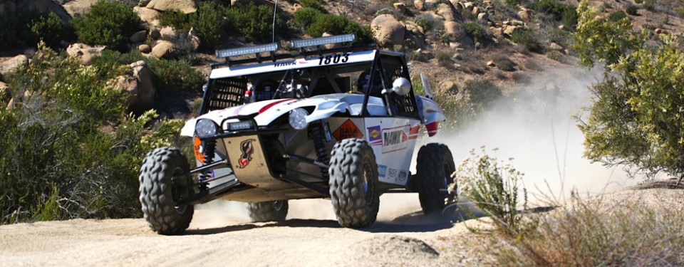

At 1600lbs, All-Wheel-Drive, and just under 200 HP, this new desert racer proved its concept in this years Baja 500. They used the same CVT design found in todays current UTV’s, but with of the help of Carlisle Transportation Products, the development of the CVT and belt that they manufacture, was able to push this car in speeds of excess of 100 MPH!! The belt never faded, and never failed. In addition the ITP wheels and ITP Baja Cross Tires lasted the entire race, looking almost new at the finish. This is budget racing at it finest. Show up to the start line, push the start button, add gas every driver change or 150 miles, and cross the finish line. Simple, flawless and executed with nothing less than perfection.
As much of the concept was Todd’s the true credit goes to Gerald King (aka Smitty) and his team of Kevin and Nacho. They took an idea and built a race car in 30 days. At many times doubting the concept, and if the car would be finished in time. Some of the challenges were as follows:
- Buy a used Apex Snowmobile (you need all the parts from it, make sure you take the right ones)
- Design a drive clutch that can be splined to work on a Polaris 900xp Rear Diff. – Transform the diff to accept type 1 Cv’s.
- Have rear hubs and brakes kit that will mount to a one off trailing arm that accepts a coil-over and by-pass shock.
- Figure out how to mate a drive shaft to a front Polaris diff, and build new font axles that will work with one off spindles and hubs. Find a 20 Gallon fuel cell that fits between the driver seats.
Don’t forget all the aluminum and steel work that needed to go into this car.
Then Tune a motor that turns 11,200 RPM so it was drivable and would last. Not blow up a diff or brake an axle. Not blow up a belt, or take out an alternator. Do it all in 30 days, and then win the race.
